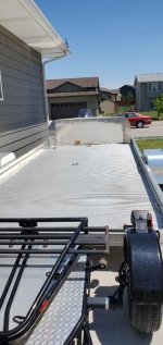

Erickson tie downs and loading

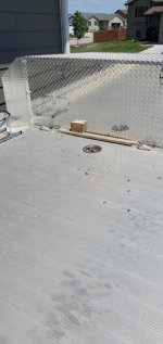

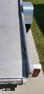

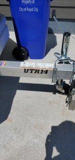

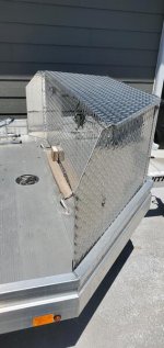

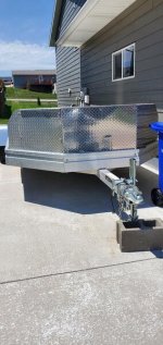

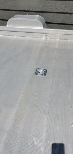

I tie my down with Erickson etrack system. You have to be careful loading a Spyder because of the extended nose and a switch that hangs down under the machine in the middle. So I bought a tri-fold ramp and separated it into three rams, as my Primo trailer folding ramp was to steep. My trailer is a 6x12 and I have a large storage box on the front when trailer the trike between Wa and Az. Box comes off for KRX SxS.
I trailer the Spyder 1450 miles twice a year, so it gets belts and suspenders. Note: I had the Erickson yellow wheel chocks front and back of the front tires and the Spyder would spin the rear wheel trying to back over them. So I switched those out for two position flat tracks.
The three ramps pin into the trailers main ramp. And two of them can move in to load a golf cart.
