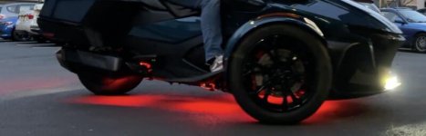

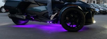

Wiring them in was pretty easy: we already had a show chrome fuse block for heated passenger grips, and putting the led light power supply into that was not hard at all. The most complex part of the process was tidying the cables up and keeping them off the exhaust pipes. The kit came with extra wires for brake and turn signal integration, and the show chrome fuse box supports that, so it all works, and it is very easy to use.
There is a switch on the original wires, but it's hidden under the left wheel arch - not ideal if you want to switch them on and off while cruising down the road. So to fix that, we added a switch into the console, and here is where things start to get 'unexpected'. But first some pictures:
Adding the switch was easy, and the one we had only came with simple instructions: you have a 12v from the running lights that keeps the switch illuminated, with a ground cable from that. Then a 12v power line to the accessory positive input. The earth from the accessory goes back to regular bike ground.
Only problem is, when I switch the light on, the lights come on one time and then after that the fuse just blows. We've double checked for shorts, and verified that the switch is wired up correctly, but the fuse still blows. We took the switch off and left the lights on with a 5A fuse, and it works just fine.
What's confusing me is that the power is coming from the same connectors on the fuse block, but just by adding a switch is seems that the current is suddenly higher, and I don't particularly understand how the current could be higher because there is a switch there.
