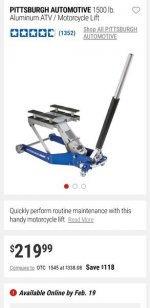

Not too long ago you could get one for $179.00 on sale, those days are gone. A hundred bucks for a gently used one is a good deal.
Another question regarding the HF lift. If I use the extensions, and place the lift on the lift rail just behind the sway bar channel, will it lift just the front high enough to place 24" jack stands under the control arms? This will keep the rear tire on the ground with a tire chock behind it.
I back up on to car ramps first then come in from the front and place the pads evenly on the crossmembers with the center frame centered in between the pads, it only takes a couple of pumps from there to place the jack stands underneath the a -arms. Make sure rear brake is on and wheel is chocked.

Can't beat that. Good buy.
I may try Cloverhillcrawlers method of putting the rear tire on a auto ramp. I'll then lift the front high enough to place 24" jack stands, remove the OEM sway bar and lower a bit for Ultra bar installment. Then while under there, install a SE front tube bumper and cat delete pipe :)
I don't put the rear tire on the ramp. I place the car ramps under the rear side of the front wheels so that instead of driving up on them forwards. I back on to them and then lift from the front making sure to use the crossmembers to lift with the center frame centered in between the pad extensions so it lifts evenly .
It will do it. Stabilize the front with jack stands...
While that works and I am not saying that it is wrong , it appears that the spyder frame is teetering on one pad until you get the jack stands underneath. I personally cringe while looking at that.
Until the jackstands are underneath the weight of the spyder can roll side to side.
If you back onto some car ramps first you can use the extensions (more height for lifting) and come in from the front on the crossmembers and have two stable contact points on the pads that prevents that roll while you get it on the jackstands.
Make sure the pads are not in contact with the plastic covers in the front and are only in contact with the crossmembers or you can stress the plastic and break it.

Thats why I did the lift in stages and level using blocks and axle stands.
Going nowhere fast and solid as a rock.
But each to their own I guess. What could possibly go wrong?
It took as long to swap the bar out as to lift it up there.
Can only but wonder why its not completed by now.
Well.. I did it. Took about 1.45 hours, giving a few breaks to some pesky vertigo. Smooth install. Used clovercrawler method with ramps. It was just slightly wobbly fully raised, but NO way I would have done it without jack stands. Yay 😊
