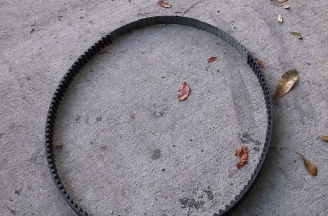

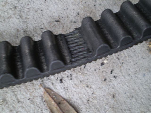

    Bingo! We have a Winner! (If, as described, it is actually a 'Click' from the belt)
    However, if we are talking about a 'Clunk' when shifting. Then this would be the correct answer. Many times, the accuracy of the description of the issue has everything to do with the accuracy of the response.

    BajaRon, wouldn't the noise from a small stone be more constant? Asking because I have not experienced it yet......................and hope I never do.
    Yes, you are correct. And it would be vehicle speed based. Not RPM based. If caught soon enough, a pebble in the belt is usually not a problem. Let it go and you can really damage the belt. A missing tooth in the belt is pretty rare and makes a much more subtle sound. Most will not notice this one.

    You will only be able to hear the stone in belt click rolling at very low speeds. Once the bike is moving a bit faster, the wind noise and engine noise will cover the belt click sounds.
