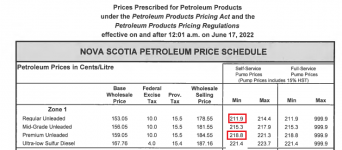

    AT 5:19 on this Smoaks video, you can hear a newer Spyder having some pre-detonation issues. However, the rest of the ride is good except for the warped rotor.
    https://youtu.be/hTCHQkHHuMc
    I put 91 octane in my motorcycle. It's 6.9 cents per liter more than 87 and I usually put 20 liters per fill-up in my 25 liter tank. 20X6.9cents=1.38. If I 'm willing to fork-out $35K on a new toy, it's not a $1.38 more per fill-up that will break my bank account. But that's just me.
    For reference: 1 US gallon = 3.79 liters
    Last edited by GFrog; 06-17-2022 at 07:51 PM. Reason: Lets try this again without diesel price

    Quote Originally Posted by GFrog View Post
    That's great for you .... currently in Vermont the difference is .55 cents, not so great for me .....Mike
