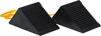

    I never leave home without my (2) small wheel chocks
