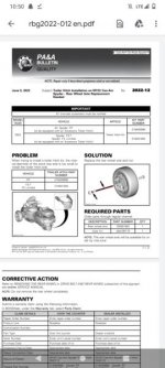

    Here is the Bulletin regarding the 2022 hitch issue and the fix. The good news is Can Am is covering it under warranty.

    Push back from the dealer about swapping 2022 RTL axle under warranty. They refused, wanted me to pay for axle swap labor and parts. Printed the photo of the service bulletin from this post, &'" took it to the dealer. Service manager finally found the actual BRP bulletin & called BRP, who agreed, & said this was a known issue, and so will pay for the replacement under warranty. They’re shipping the correct axle today. If not for this forum, I’d be out $$$$$$!
