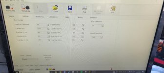

    So one of my buddies just bought a 2013 CAN-AM RT Limited from a women that had it from her husband. he just asked me to check out a problem where the bike would shut off on low rpms and would not start back up unless you turn the key to off and on position again. I decided to check the fuel, sparkplugs and discovered this. I have no clue what they did to the bike, but the airbox is swapped for the direct air intake, the spark plug wires are swapped. There is a GlowShift Digital Wideband Air Fuel Ratio Gauge Kit that doesn't work, a belt stabilizer and a bunch more minor stuff done to it.
    So I realized that it must be tuned and connected BUDS. No errors, no occurred, nothing. I started poking around because I couldn't find the Power commander and found this setting. Haven't seen it on any other Can-Am before, and this looks like its what I'm looking for. Anyone knows what it is? Anyone knows what anything is?

    Looks like you have a MegaTech License? I've only seen that page on a MY 2013 and 2014 ST. Look at your Demo files that came with BUDS - with your MPI plugged into the computer so you have the correct privileges - and check out the 2013 ST Demo File. All that page does is allow you to calibrate the fuel gauge sender, tach and speedo. Those numbers correspond to the fuel gauge sender output for the Low Fuel Light, and each bar on the digital display fuel gauge. Those numbers look correct for a 2013 and are the same as the DEMO file numbers. That's not the cause of your engine issue.
    Back to the engine - are you saying it won't idle at all, or will it start and idle for a period of time and then shutdown? If it runs for a period of time just fine, and then turns off, time it. See if the time that it runs is consistently 2 minutes. Turning the key off and back on will also reset the fuel pump prime timer. The one where the pump runs for about 10 seconds and then turns off. Could be a fuel filter or fuel pressure regulator issue. The 2013 recall did re-work the fuel system. Those are just off the top of my head.

    Good morning! Thanks for a fast reply. I didn't find the power commander. there was a wire going to the 02 sensor which went to this box which i assume is the wideband controller. The bike ran first try 1:47 seconds, second try 1:59 seconds on second try. No throttle applied. Ill check if they did the recall today.
    I think that the whole Wideband thing is going to be a red herring for you. Without a tuner, the AFR meter is just indication only. Wouldn't affect operation. But if it was me, I’d disconnect everything. The reason I was curious about 2 minutes is that, if there was a previous goof up with programming keys, the machine will shut itself off after 2 minutes. If you can keep it running beyond that just by applying some more throttle, then it won't be related to that.
    So, if you CAN keep it running, hook up your BUDS to the machine and go to the Monitoring tab for the ECM. Start up the machine and watch the two Oxygen Sensor Status boxes. Make sure that they both shift from Heating to Active. That would take about 4 - 5 minutes. If one of them shows a failure, then replace it. If that's all ok, then I would go back to the fuel system - delivery, pressure, cleanliness, etc - and check your vacuum hoses...run some Seafoam through it...all of the usual 998 things. It’s all here in the forum. Google is your friend. Good Luck.
