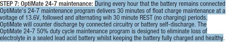

    It's that bit that can catch you out dolittle, especially if you aren't riding your bike regularly!
    You really shouldn't put your battery on a battery tender if you're going to ride your bike within the next week or so, or you risk taking it off the tender and being able to start when you're at home, but then finding out the battery is really toast later on that day when you're 100 miles or so away from home when it fails!! And as oldguy discovered, it always pays to take it off the tender a day or so before you want to use it again. Sure, that way you might still be caught with a dead battery when you do go to use it, but at least you're home & you might be able to do something about it!!
    By leaving it for at least a week
    2013 RT Ltd Pearl White
    Ryde More, Worry Less!
    Jun 2016
    Harrington, Australia
    4,174
    Hahaha……yep…….as Oldguy AND ME discovered, Peter. I now only put the RT on the tender if it is going to sit for a couple of weeks……and never before an overnight trip. It’s working well so far …….ooooops, I probably shouldn’t have written that
