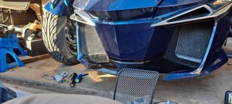

    I have the KOTT grill covers and ended up not installing them on my 2022 because I could not get them in place without bending them. Anyone have any suggestions? Yes, I followed the instructions.
    They are a little tricky/frustrating for sure. You may need to flex them a little but not enough to bend them. You just need to get them in the right angle, and they will slide right in. My Right side was a lot easier than the left which I did 1st.
    Also watch the install video, it helps a lot.

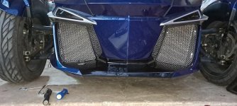

    Because of the impending Cicada-geddon that's about to be unleashed by Mother Nature, I decided to get a set of the KOTT grills installed before the radiators get embedded with the nasty buggers. I know they won't keep everything out, but they'll certainly help. I purchased the upper set of covers as well, which requires the removal of a few pieces of Tupperware to install, one of which is the piece that makes up the splitter in front of the air intakes. With those removed, the intake grills went in super easy. They literally just slid into place after getting them lined up.
    Also to note, after having the grills in hand, it's easy to see that the size of the openings in the wire mesh are plenty big and will most certainly not restrict any airflow to the radiators. Photographs can be a bit misleading.
