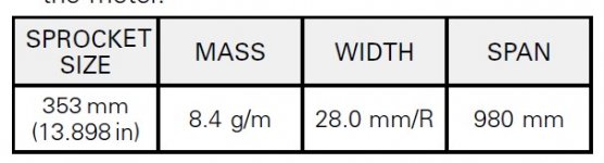

    From the service manual-

    No actually I need the values to calculate the proper Hz for the appropriate belt tension

    Thank you Jetfixer. After reading your post I looked again and found it in the service manual. I do appreciate your efforts.
