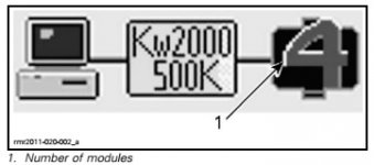

    Yep CAN (BUS) is on that list. Although I'm pretty sure my and earlier Spyders use KWP2000 which is also on the list. I surmised this from this service manual picture.
    And the CAN-BUS does run at 500kbps.
    PS I said CAN-BUS was cheap and Wikipedia agreed with me.
