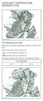

Thank every one,
I did wonder about the temperture sensor!
Silly question, Where is the temp sensor??
have looked on parts list but can't find any mention of sensor.
Thank every one,
I'm guessing it's the CTS (Coolant Temperature Sensor) that feeds that gauge. Here's the relevant pages from the manual for location and testing.
