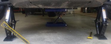

After messing around with other solutions, and not wanting to spend upwards of $2k on a lift table, I thought I'd try these inexpensive screw jacks.
The two for the front are standard automobile jacks rated at 3000# each and come equipped with their own ratchet wrench. $30 each https://www.amazon.com/Amvia-Scissor-Jack-Car-Compatible/dp/B083X74ZRX
The blue one in the middle is designed for Motorcycles and rated at 1100#. I should have pushed it further under the frame, but even so it worked just fine. $80 https://www.amazon.com/LiftMaster-Motorcycle-Center-Scissor-Hoist/dp/B01NCT4IKW
