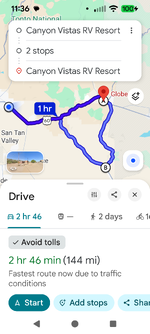

I have had this system on my F3 for a couple weeks now and several rides and the it has worked perfectly. Starts up and launches each and every time the bike is turned on. Even remembers what I was listening to (I use an app called PlexAmp to use my large music library at home and on my phone). Google Assistant works great through the headset. I have searched for locations and navigated there using voice command as well as asking for weather and news.
