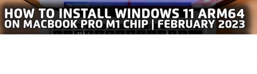

Just as a warning - if you have a newer MAC with an M1/M2 chip, Windows will not run as a guest operating system - parallels/vm fusion. I am not surer about dual-boot, but I would expect it will not work. Older MAC's used an Intel chip - the M series use AMD, with a different instruction set.

That can't be right! There is tons of info out there on how to install WIN11 ARM64 on Mac Pro M1/M2 machines...

Update: installed Parallels on my MacBook Pro with M3 silicon, WIN 11 Pro, and connected the BUDS system. The downside is that Parallels requires a fully legal WIN install. I was trying to transfer the license off my older MacBook with Intel silicon, but didn't want to jeopardize getting it restarted (as I would first to have deactivated it on the older laptop). With all of the software loaded, I still needed to manually configure the USB/Serial connection to the MPI 3 device. In the WIN11 window, go to Devices=>USB, note if you can see the USB-to-CAN V2 device, if not remove/replug the USB cord. Go further into Configure=>USB Preferences=>Permanent Assignments=>(click on the "+" sign until the USB-to-CAN V2 device is showing in the window). Double click on it and assign to WIN 11. If other devices have populated that Permanent Assignment window, click on the device, then hit the "-" to remove any permanent assignment.
