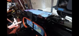

I tried to open it and the app opens on the phone but because the phone didn’t go dark again and revert to BRP Go the dash failed. As I mentioned, there was an update to Dash Radio a few weeks ago and BRP Go got an update over a month ago. So the latest change is with Dash radio, therefore it can’t be the BRP system.
