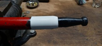

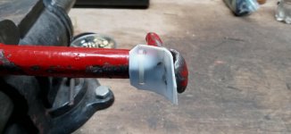

Here's an easy mod to the original mount bar that comes with the HF tire changer. It doesn't bugger up the rims and makes dismounting the fronts as easy as peeling a banana.

What is it?
The pictures are of a mount dismount bar that comes with the HF tire changer. If you have one you can see what I did to make it work without scratching your wheels. The dismount end is a replacement No-mar tip and the mount end has a piece of laundry detergent jug zip tied to it. It only makes sense to someone that has the HF tire changer that the OP was referring to.
I understand now. Thanks
Looks good Gary. How did you attach the Mo-Mar black tip?
The tip fit inside black iron pipe (I think it was 3/4 inch) ,then that fit in the mount/dismount bar. I used a roll pin to hold the tip.
