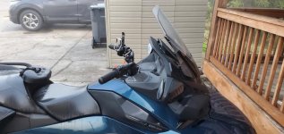

Thanks for the replies and images Troop, I do have one question, anyone got a image with the difference between the Long reach and Attitude bars? From the link MRH (Thank You) left shows some difference between the bars except it looks like the Attitude bars are actually lower than the drag bars (as the drag bars looks like it is on spacers) So my question now is does anyone have a image of comparison between Long Reach bars and Attitude bars? I know looking at the BRP site the Attitude bars look like they may be similar to Beach bars that were on Motorcycles where your wrist are kind of turned in somewhat more than stock bars.
I've got my Attitude bars boxed up, ready to ship, but I'd say the inner ends of the grips are probably .5-1" higher than the long reach bars. They're not any wider. The big difference is the grip angle. The grips are canted in and down slightly. You're hands won't be any/much closer to you but the grip angle is much better. I'll attach a couple pics of the Attitude bars on a 2021 RT.
Best pictures I've seen of the Attitude bars installed. I just might like those :)
Great pictures. Thank you. I ordered a set of long reach which should be here Wednesday. I modified my stock bars to give me the reach I wanted but in doing so I killed what little view I had out the mirrors. So hopefully the long reach will give me back that rear view I'm used to but still maintain my arm reach.
