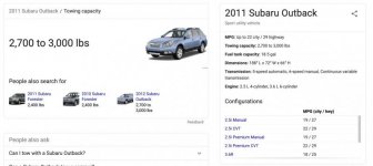

I have no experience, but here is what I found on the web. Assuming your Spyder is 1000 lbs, then you have 1700 lbs for a trailer. This may limit you to an aluminum trailer.
