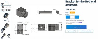

BTW Firgelli offers a bracket for the rod end if you don't want to fabricate one.
