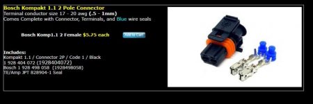

This looks like the right one. Boschs version of the amp connector. See picture. If it is. Then look on Ebay for the pigtail. That is if you or someone you know cannot make a new pigtail from the parts.

Do some research before buying as this is a female connector. Look at the metal contacts. They are made to accept the flat pins that are showing in your damaged connector which is the male plug. Doesn't do any good to buy a connector and have two female ends.

The connector in the pics with the quarter is a male connector with the flat pins. I don't know if it came from the sensor or from the harness, but it has male pins. The one in the attachment photo has the female ends and is described as a female connector next to the price. It appears to be the same as the connector in his pics, but the metal terminals are not the same. Look before you buy.
Bosch appears to have male and female terms reversed. Look at their connectors here: https://www.automotive-connectors.com/bosch-1-928-404-072-2-way-female-compact-connector-1-1.html.
RowdyScamp, make sure you get the right connector. The one in your pic is, as Billy shows, a Bosch compact 1.1 series. Most of the connectors of that type on the Spyder are Amp Superseal 1.5. They won't fit together. The Bosch has horizontal flat terminals and Amp are vertical flat terminals. Most of the connectors I've seen on eBay are AMP Superseal style. You may want to just buy the parts and pieces to assemble your own connector from the website above, but it's in Germany.

My spyder is up and running again. On Saturday I did a visual inspection, spliced wires in, and wrapped new friction tape on the harness. The connector arrived in the mail today, and it was a simple matter to get it installed. The hardest part was getting my hand in the space to plug it in. Forecast showing daytime temperatures in the 50s and 60s coming up, so it could be a good time to ride.
For what it's worth, the old connector is female, and the one shown in post #11 is an exact replacement.
