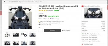

Just went out to garage and checked with Mr. Fluke, these are the Elite LED HD 360:
PER BULB @ 14.4 VDC idle
HI - 2.4A = 34.56W
LO - 1.3A = 18.72W
HI = 4.8A Total
LO = 2.6A Total
SlingMods states 30W
possible be correct because it does have a boost driver on it I think, at about 19V so that will bring it down to ~30W or so
