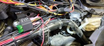

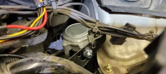

After installing a Motohorn on her 21 F3, it was time to put one on my 2020 RTL. There is no kit yet for this install, so I just kind of winged it. First off let me say it's a lot harder to do on an RT than the F3. Getting to the factory horn for the wires is a bear. After that, it was just a matter of picking locations for the relay, compressor, and trumpet. This thing is extremely loud!! These photos were mostly taken while I worked. The final installation is much tidier.
