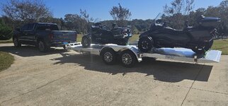

My Trailer Loaded for a Service Run
Snapped a picture of my aluminum trailer with chock mounts. The tilt trailer was made to be low and the Spyders load sooooo easy.
I also have a 12 footer with a ramp set up the same way, well for a little while - I can't justify having two aluminum trailers! HA

Just an observation... It looks like you have nylon ratchet straps going through the wheels. I have done that too, but I found after trailering some distance, that the wheels can abrade the straps and cause them to fail. It doesn't take much of an edge and/or movement to cause a problem. After I nearly gave myself a heart attack seeing my tie-down had failed, I started using good padding on the wheels. No more scary problem.

Appreciate the info, I have never had an issue with the rear doing anything but the wheel chock tie downs on the front bear the most load. Rear just keeps it from bouncing if you hit something. I would not even use them but under heavy braking or god forbid a front collision, I feel better there is a little more helping the forward motion.
