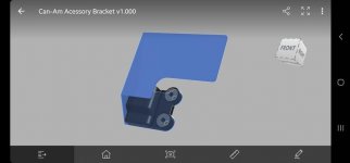

My top secret accessories not really top secret. :sour: I'm adding a dash cam, a BSM System, and Lighting; but to do so I will be creating a sub-harness and adding an OEM style fuse block and custom harness. To that end, I am looking to find "OEM" ways to mount parts cleanly. If I can buy an OEM bracket that will accommodate the camera Power supply, BSM module and controller, and the fuse block then I will do it. It saves me time to have a custom bracket made. It will also allow me to utilize OEM mounting locations and holes to prevent drilling. My OCD will not allow me to just splice in an accessory, then have a crap-ton of wires everywhere in a huge spaghetti mess. I want anyone who looks to not know I added anything. Like I said, it's my OCD. :dontknow:
I am preparing for not being able to use OEM parts and needing to make them, so have started a preliminary design (see the attached image). This is one of 3 current designs to mount components (design is not finalized) utilizing a current location - the D.E.S.S. mounting bolts. And yes, I measured and modelled the D.E.S.S. module so I could use it when working thru the design. I have been 3D printing parts to test before finalizing the design and location. I will then need to have them fabricated and powder coating. I typically work through several iterations to simplify and customize for fit before its done. Good thing I have all winter. lol

Thanks, I likely won't have the place to install one on my F3S. After poking around, I believe I saw some having amps in the back, behind the passenger location - again, I don't have the longer backend of the RT or F3-T with the space to accommodate anything.
