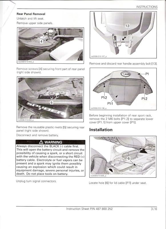

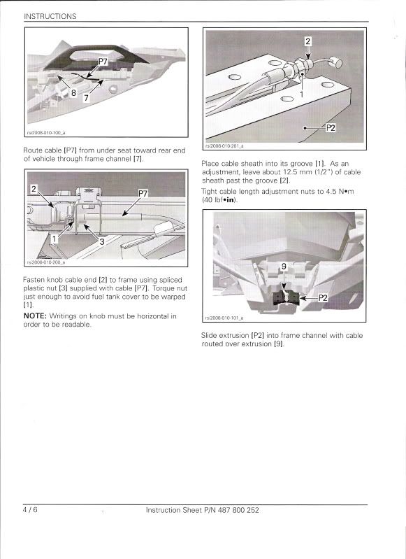

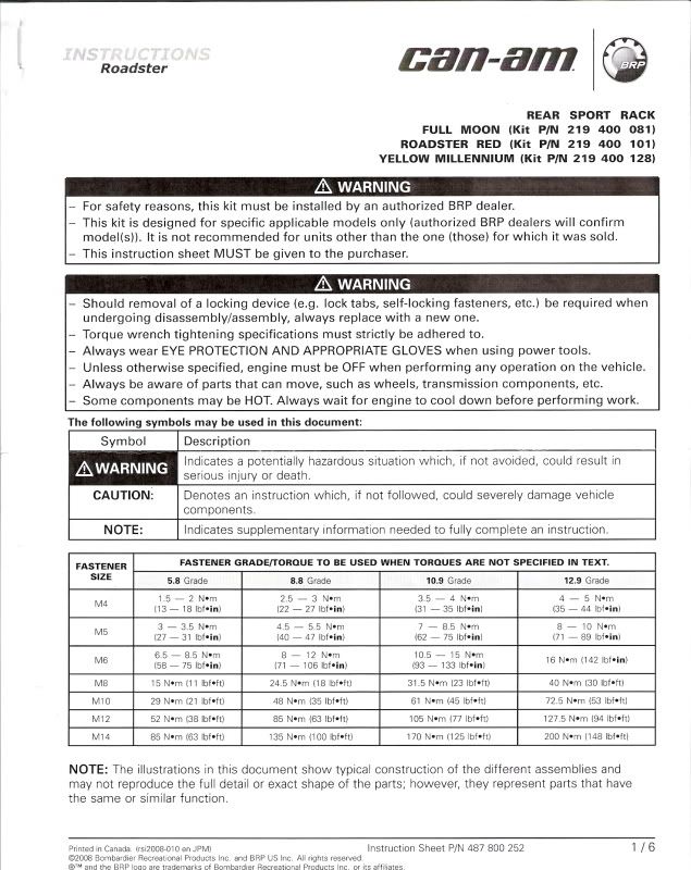

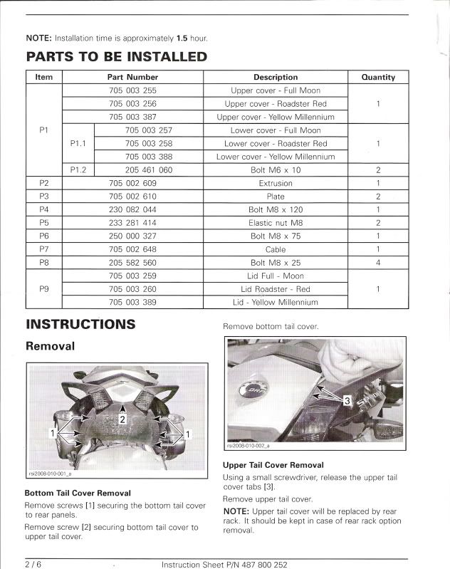

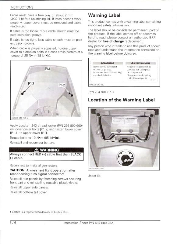

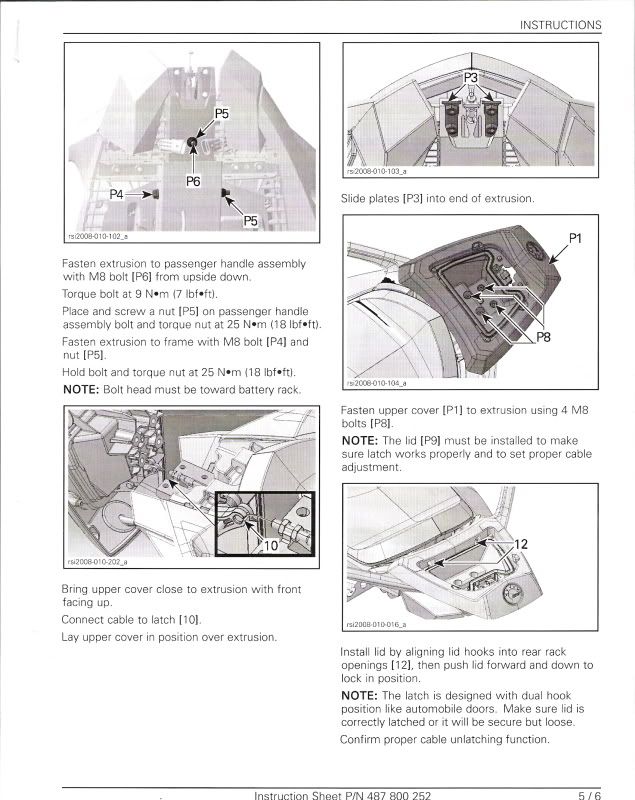

I need one too. The backrest is solid because it has that lever to lock it down, but my sport rack rattles like mad...something needs to be adjusted, but i tossed the directions...:banghead:
