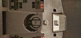

The Shad box baseplate needs to be secured to the LinQ base. The LinQ base needs to be secured to the RT using the twist lock.
Question: How do you twist the knob if the Shad base is bolted over the access?

Hole saw. I think a 3" one will do the trick.

NOTE: The center lock is a bitchkitty to turn. Maybe mine will get better over time but I had to use a pair of pliers to turn it. No way I could do it by hand. At first, I thought it was broken. That's how tough it is to turn.

I had to be able to access the center lock or none of this would have worked. I drilled a hole in the Shad mount with the 3" holesaw I bought from LOWE'S. I still need to get my Dremel out and clean it up but I was worn out and wanted it done.
