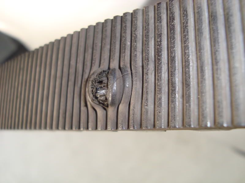

While patroling a gravel road on the levee on the Vidalia, La side of the Mississippi River yesterday, I high centered a couple of times. Upon returning to the pavement and accelerating hard, my new RTS had a terrible banging sounding like metal against metal and some slippage. Slowing down made the hammering go away but it is repeatable. The dealer is 100 miles away.
Before I go there, what do I look for? Thanks for your thoughts? Maybe a rock messed up the belt???
After jacking it up, nothing appears wrong with the belt and cogs, but the rear axle does not seem lined up correctly. The tire wobbles. Is this something that I can do or does it need to go to the dealer? Does not appear to have any visible damage from the ride down the gravel road.
Bad bearings or hub failure. You need to see the Spyder doc...preferably on a trailer.
