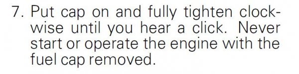

Gas caps are made to click to assure the user they have been properly tightened.
From my 2011 Spyder's Owners Manual:
So you will weaken the cap if you follow the manual?
