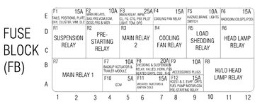

I have a 2010 RT SE5 that I haven't tried to start for about 6 months. I keep it on a battery tender. I generally start it every month or so to keep it running. However, the last time I tried to start it the engine turns over great but it won't start. The interesting thing is the fuel gauge doesn't move off empty. There is a half tank of fuel. I thought it might be a fuse but everything looks ok. Any thoughts before I trailer it to the dealer? TIA Tom
