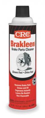

I too use a spry to shine up the front tires. I then spray the pads & rotors with BraKleen, and have not had a problem.
