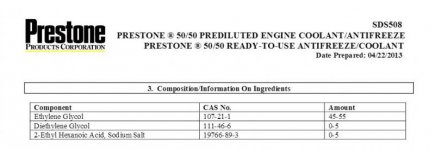

years ago, i had a leak in my RS 990 Water Pump... the dealer replaced the pump, and filled her with PRESTONE ANTI-FREEZE... i never had an issue again, and i put over 35,000 miles of smiles on her after the replacement...
i'm planning to go thru all the systems on my F3 for our ride out to Deadwood this July... with 46,000 miles of :D on this one, i'm think'n it's about time to change the anti-freeze in my 1330.... has any1 used a different anti-freeze other than the BRP/OEM product...??? the OEM is a 50/50 blend and you can get the PRESTONE 50/50 @ most any Walmarts or auto stores....

I changed mine over the winter and used Motormaster brand Extended life Orange Anti-Freeze. BRP's is no better that the major brands Prestone included. The only difference is you can buy a gallon for the price of a quart from BRP.

When my RT developed the well known hose leak I've always just topped off with the standard universal Prestone and have never had any issues. It's either a HOAT type anti-freeze or it's not. The BRP branded stuff is nothing new or special, nor is it made by BRP. It's just sold by BRP in their own packaging and their own pricing.

I used Vanguard universal 50/50 antifreeze with an aluminum engine rating from the local auto parts store. No issues. Antifreeze it antifreeze in my opinion.
