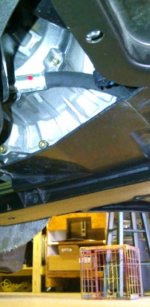

Spent the day installing a few goodies from SpyderPops and want to thank them for their quality products and good instructions for installation. I got the 'Possum Pusher skid plate, right side air vent cover and chain guard. I saw the possibility of saving and using a portion of the under radiator guard which attaches horizontally. Pictures are below if you can 'cipher them. If you have made this change, you will be able to follow the pics. If not, when you do make this improvement, you'll have this added advantage. I practically halved the shield and reattached the side nearest the engine as it has three (technically) attach points: two screws and one cross member clip for stability. There's little or no stress on this and I think it probably adds a bit of security for rocks, particles or whatever small that might hit something up in there. It did not adversly affect the cooling of the engine and we've had high eighties under radiator plate cut.jpgunder radiator plate.jpg here today. A jigsaw does the trick.
