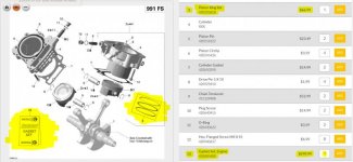

Seeing this is enough to bring a tear to your eye.
If you are unsure why or what you are looking at...
This is a photo showing the bottom end of the engine from the top down. With pistons removed I was able to see down into the crankcase and verify the great condition. Note the oil in the photo... it has not been saturated with water. If what was found was a layer of water separate from the oil layer or if the oil was completely saturated with water... the bottom end would have been destroyed and the "put it back on the road" part of this project would have likely been over. Happy days!
