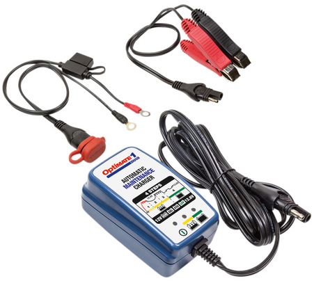

Lamonster sells this one. It says it automatically transitions from charge to maintain. Is this the kind you were talking about @BajaRon
