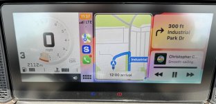

Is anyone having these problems with an F3. From all the posts it appears that all posts are from an S2S or RT. Does not make sense or am I reading this wrong.
