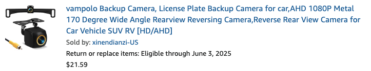

I've been following these camera threads from the beginning and became more interested when it sounded like any universal backup camera might actually work. A $30 camera from Amazon and a so-so matching 3 pin plug from the local U-Pull-it yard and I am up and running. I routed the pigtaiI and receptacle onto the cavity under the top case so any changes or adjustments can be made without major disassembly. I have the correct 3 pin plug ordered but it is coming from somewhere in mainland China so with the current tariff situation I don't know when or even if I will get it.

What camera and pin connector did you use for you set up?

@amkrat, can you give a link to the camera on amazon and give any details of the pull-a-part three pin connector you used (vehicle pulled from, location in the vehicle etc.) Thanks very much!!

Not sure how much help I can be here. I think almost any camera that you find on Amazon or Walmart will work. What attracted me to this one was the screen resolution and the ability to delete the camera grid lines. Hopefully you can expand the image below to see the camera details. At the junk yard I was simply looking for any 3 wire plug/receptacle pair that I would use to just do away with the Can-Am setup. I think I found it under the hood of a early 2000s Ford car but I can't be sure. It was a stroke of luck that the male pins lined up really closely with the Can-Am female slots, and were small enough to fit. Just dumb luck on my part. The housings don't quite match up so they don't snap lock together but there is no tension and a few wraps of black tape should secure them and keep any water out. If I had to do it all over again I would just go to O'Reilly's or AutoZone and buy a new 3 pin set.
