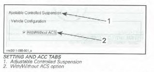

I'm believing that the 2016 models are going to function the same way as our earlier models since everything seems identical. So, this is what I believe is going on with yours.
The key thing here is that the problem started after the cluster replacement. The gauge cluster is what controls the operation of the automatic ACS system. First thing then, the gauge cluster needs to be told that your machine has the automatic ACS in BUDS. The BUDS screen looked like this for my model year and should be similar for yours. Check the box for "WITH" the ACS. I would also suspect that your technician also needs to perform the ACS sensor reset and calibration procedure, since all of that data was stored in the old cluster. That procedure is also done via BUDS and two blocks of wood - one short one and one long on - which set the low and high positions of the ride height. So, correcting this shouldn't be a big deal, just another trip to the dealer so he can finish what he started. Let us know how you make out.
