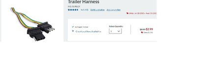

I have in seen in auto parts stores a 1 foot long extension cable with a flat 4 on both ends. Just thinking that cutting the male end of that in half and making a square 4 out of it. That would be cheap and the trailer can still be towed by another vehicle.
I bought a square 4 pin and a flat 4 pin on amazon and made myself a little harness (from etrailer). That way, I have the exact sizing for my setup.
