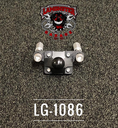

I wish to thank all for your responses on my quest for a GPS mount. After several months of procrastination, along with a fair amount of research, I finally addressed the subject and made a decision, which would not have been possible without the help I received from this Forum. My Lamonster mount, Plug-n-Play Harness, and Zumo Security Lock are on their way and should arrive in a couple of days! :)

I used the mount from Lamonster and their wiring. They do say that the polarity could be backwards. Thanks to Can AM.
