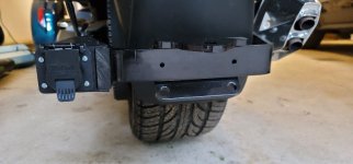

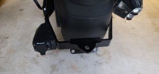

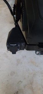

I use a 7way plug because I have breaks on the trailer and batteries for light, fan, ect. that charge as I ride. 20210615_205012.jpg20210615_204957.jpg20210615_205021.jpg
