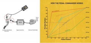

No, it won't.
Look at the Pedal Commander drawing. Pedal Commander plugs in between the twist grip and the ECU. It alters the signal to the ECU. It does not change anything in the ECU. Pedal Commander provides a chart illustrating what Pedal Commander does to the twist grip signal. With Pedal Commander, to get 100% twist grip signal to the ECU, you must twist 100%. Same as without Pedal Commander. At 100% twist, you get 100% signal to the ECU in either case.
How do you get maximum acceleration from a Ryker? Open the throttle 100%. How do you get 100% throttle with Pedal Commander? Twist the grip 100%. How do you get 100% throttle without Pedal Commander? Twist the grip 100%. Same change in power output in the same amount of time in either case, therefore, same acceleration.
Look at Pedal Commander’s response chart in City mode. If you twist the grip 30%, Pedal Commander sends a 50% signal to the ECU. You get the same signal to the ECU as if you twisted the grip 50% without Pedal Commander. The acceleration in either case has to be the same, because the ECU has not been altered, the throttle body servo motor has not been altered; nothing except the twist grip input to the ECU has been altered. And, by Pedal Commander’s own chart, that signal can be exactly duplicated by twisting the grip a bit more without Pedal Commander.
No question Pedal Commander changes twist grip sensitivity, but it does not and cannot change acceleration.

Im not talking about the pedal commander, im talking about the pedal box. Default throttle response is at 65%, pedal box sets it to 94% so even if you go max throttle within a millisecond, you wont get max power until the set throttle curve is done. Having a more aggressive curve will give u max power sooner when you twist the throttle, instead of as it is now where you twist the throttle max but the signal to the engine will have a slow wind up curve, like slowly twisting the throttle on a wired throttle. Probably wont do alot but it will help with the slow response the ryker comes with by default. Feels almost like turbo lag.

Pedal Commander, Pedal Box, Sprint Booster, all variations of the same thing.
Your statement "as it is now where you twist the throttle max but the signal to the engine will have a slow wind up curve" is not correct. If you twist the grip 100% you get 100% signal to the ECU, with or without a Pedal Box. Unless you are in the Ryker's Eco mode, the throttle is going to open fully virtually immediately. The curves that Pedal Box shows is the signal to the ECU, not the signal out of the ECU to the throttle body. The Ryker's default mode is not a slow response; it is only slow in Eco mode.
I extensively tested a Sprint Booster decades ago. Drive by wire throttle bodies have a TPS (Throttle Position Signal) to the ECU so that the ECU knows exactly the position of the throttle opening. I recorded the accelerator pedal signal to the ECU and the TPS signal to the ECU with and without Sprint Booster. The TPS (and thus the throttle opening) tracked the accelerator pedal signal to the ECU with virtually no lag, with or without Sprint Booster, and the tiny amount of lag was the same in either case. Pedal Box response is not going to be any different.
I can make the same measurements on my Ryker, but I already know what the result will be.
