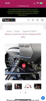

He basically installed it per the directions but mounted where he could since the A-arm is a little different to that on the old RS/ST (less plastic). He installed it, tested it, and it works great.
Second pic is the kit he used from TricLed - it worked well on our 2022, just had to move the placement a little on the A-Arm
