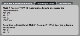

Again, I am curious, not starting anything. My main reason is my plans are to use Mobil 1 motorcycle oil. But may use Rotella if acceptable.
It should really just come down to if the oil has friction modifiers or is labeled "energy efficient".
This is what I am using for info
http://www.mobiloil.com/USA-English/MotorOil/Oils/Mobil1_Racing_4T_10W-40.aspx#
Rotella also meets SM, just not sure if it has friction modifiers

Not to jump into an oil thread, but that oil is fine for use in the Spyder. It has the same basic ratings as the Amsoil that is the favored product by many owners, myself included.
I believe what BRP is referring to in the manual about prohibiting SM grade oils is a direct reference to automotive SM oils, which was the automotive industry standard from 2004-2010, and not oils approved for wet clutch applications, like the referenced Mobil 1 product. :f_spider:
