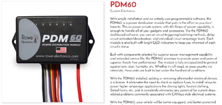

Hi Jaxansandy, I appreciate you're specifically looking for an existing AC1/2 circuit but have you considered a Power Distribution Module? Wired direct to the battery and then mounted where suits it'll be your central hub to connect all your accessories.
Lots of makes available, most are programmable, ignition switched Y/N, and usually negate the need for relays should you hook up a high power draw accessory.
I've just ordered a PDM60 for my F3-S but as they say, 'other makes are available'.
Andres
