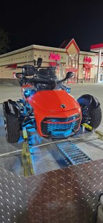

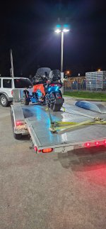

I have a 28' Intech ICON trailer.
It has heavy duty tie points for the car, as well as several rows of e-track along the length of the trailer.
I'll be carrying my Spyder along with my race car, using the e-track to tie the bike down.
I dislike the tire straps. I plan to add eye nuts to the front lower shock mounts, and make a shaft to go through the rear axle that I can thread eyes onto each end to secure the rear. It will be easily removable when not in use.
I brought it home on my open aluminum trailer, using axle straps through the A-Arms and swing-arm, but I want a more permanent solution.

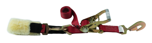

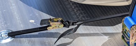

The ratchet strap over the rear tire is a bit of a pain to install. When I do the 1550 commute AZ to WA and WA to AZ, I put additional side straps on the rear wheel, and straps from eyes on the lower shock bolts to pads on the trailer deck. Belt and suspenders! I found that the Spyder did not like backing over wheel chocks behind the tires, so I replaced those with three slot flat tracks (Picture one).

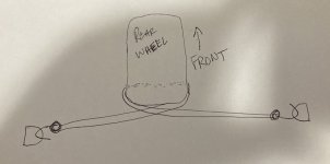

For the rear tire you have to worry about the drive belt sprocket.
Facing the same direction as the Spyder, so left is left and right is right.
Feed the strap through the wheel from right to the left or left to right, whichever is easiest for you.
Then take the strap that comes out of the right side of the wheel and pull it over to the left side of the trailer passing over the rear of the tire.
Then take the strap that comes out of the left side of the wheel and pull it over to the right side of the trailer passing over the rear of the tire.
Like this:
6x10 aluminum open utility trailer with aluminum deck. Looking for aluminum etrack instead of the standard steel track,(rust issue) only reasonable place I found was Mac's. Was going to fasten with stainless bolts, just for the front wheels, ratchet strap thru rear wheel as the diagram above to rear corner deck rings.
