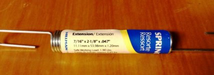

In order to help the OE spring pull the pedal up so that it turns the brakelight switch off properly, many have simply added one of these...

If it's not the switch, and you don't find a return spring on the brake linkage, that don't mean you can't put one on there some where! Possibly a good cleaning under there and a little lube on all the linkages and a switch adjustment is in order!:dontknow: good luck check it out! Let us know what you found!
