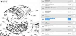

Yes I have a 2020 F3L and thanks to the folks here, I was able to confirm and get the covering.
The part is the same for the pre-2020 as linked above.
What the black cover panel does not come with is: the BRP stick on logo (I got mine through Amazon), the metal clips that secure the panel in the three rear slots, and two push pins that secure the panel at it's front.
Diverd - did the rear fairing for the 2020 F3L come with all of the necessary clips to mount? I see that VitoNam's post states it does not. Can you kindly provide part number - and if you had to get other parts, what they were and where you found them?
