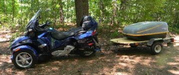

Got my custom made converter cable to connect from my Spyder to my trailer's flat four plug from Doc Riverside today. I also installed it on the trailer hitch.

Took it for a spin.
I have been driving around with my trailer to see how it feels? Interesting in trailer mode as the Spyder drives different as far as accelerating. Practicing backing up too. What a joy. :ohyea:
Bought a spare tire for it at Northern Tool today. I have an old scissors jack from a Datsun. Will be getting a lug nut wrench setup too.
